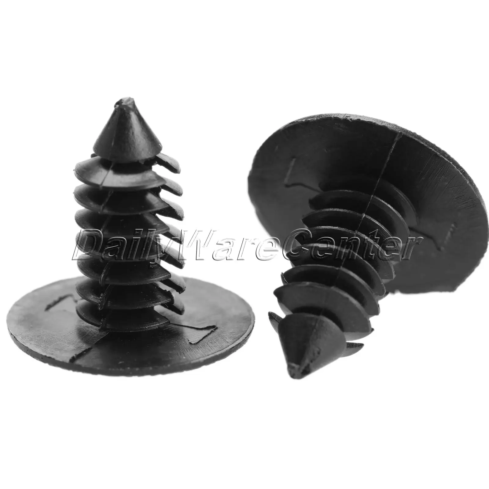

On a 2002, I would use the universal, one time use ones like these:
Snap one off using a a
Small nail puller or molding pry bar. You may even salvage half of them but don't count on it. Then measure it and ebay or Amazon a bag. From a dealer these idiotic things are outrageous around $1 each and you'll ruin most you ever try to pull. With that in mind just get a bag of 25 or so. You'll need them sometime.. about the only good thing I can say about these as a fastener is that they don't promote rust.
Toyota part 52161-16010 goes into a 9mm hole.
A search for that number on Ebay will give you multiple look-alikes. Also many auto parts stores will sell 2 similar clips for about $4.
