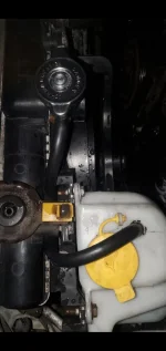

Hose routing. My car will put coolant IN to the tank. I've been having GREAT difficulty getting it to suck it in and back down, leaving the radiator low on fluid level.
Before I go crazy. Will my hose routing as pictured work? And why or why not? *edit: Before you asked.. Hose is "not pinched" as much as it can be. I can adjust this by how close it goes to over the yellow cap. It is the long curved bend I am hoping would "hold vacuum" or not. Also, if I should put "electrical tape" around where the hose slides into the overflow.. or just buy a used reservoir with hose already in it, although that may not be needed......
Notes:
1. I MAY have seen it suck down coolant ONE time. Have seen it not more than. Results inconclusive.
Tonight, I have a point where the fluid in reservoir sat when car was running and warm/hot with good heat out of vents at idle.
2. Hose is about halfway down the reservoir, where the line is.
3. Fluid level is about 2 inches above that. Can barely be seen but is green.
4. Suspecting bad OE cap from dealer possibly due to NOS, valve maybe not opening to allow return. As such, new aftermarket 16psi cap (yes, from Autozone) is on there. Spring area is constructed different. Whichever cap works, wins.
Idle is smooth.
Checking with the experts here so I don't go too too crazy. Should I buy another hose kit and not cut it and let it get to the bottom? Will as pictured work at all?
I cut some length before trying new routing. So hood prop rod and hose do not intersect...
Also.. has anyone else ever gotten a defective new OE cap?

It may be the cap and hose, it may not. You may have a small leak, anywhere. Are the main hoses hard and rigid (under good pressure) when the engine is good and hot?

@meep Didn't exactly check the hoses beyond checking clamps (they didnt appear abnormal to me.. fixed an external leak at lower hose a week or two ago. Was clamp) but it did turn out to be "a small leak." I'm even anxious about removing the cap at all now.
Here is a clamp I adjusted:
The end result is this:
Level moved by itself. Anxious about removing cap at all . Clamp on hose to overflow under radiator cap. Old radiator cap re-used is my anxiety (does it "seal better" I do not know. Have been told you introduce air whenever you remove it. Again, am anxious to take off.) No cross-contamination of fluids.
This all started after I discovered an external leak here, decided it was the poor clamp and then looked at other clamps which brings me to the first paragraph.
The leak introduced air which made the system look like this some weeks ago and the problem has since been resolved, again my hesitancy to remove the cap since the overflow level changed.
It hasn't done that since changing the hose clamp.
I'll keep an eye on it 👁 but it looks like if I just leave it alone.. that it will be okay. Coolant level in overflow moved for the first time in weeks of fighting with it yesterday. That means I fixed it.. right? (If overflow level moves, it is done, I got it?)
