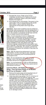

Looks like you have to eat your words. This is the tsb they posted on the previous page and GM did refer to it as a shield.
Boy...you really dug for that. 1 word buried deep in the TSB. The most important part of the "fix" is still a new valve cover with a "baffle"-you know that thing that covers the valves. Part of which is part of the AFM system.
No not really. It's listed in the title as an "AFM deflector" but if you actually chose to scroll down and read what that is and does, they call it an "AFM shield".
I wanted to know because I hadn't heard of it either. The tsb for my older 05 truck is only the new valve cover, but the shield is literally what he was telling you about and you basically tried to call him an idiot. I will admit I spent an extra minute looking because it was you. I've seen a few infuriating posts by you before. Lol
