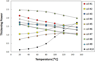

Here are some interesting conclusions from an older paper on base oil viscosity and VII's:
Base Oil Viscoitiy and VII by Lubrizol India - HTHS and SSI
Do you have some additional scientific information to include? Not sure what you are trying to convey.watching this thread agree with some of it some not so much
