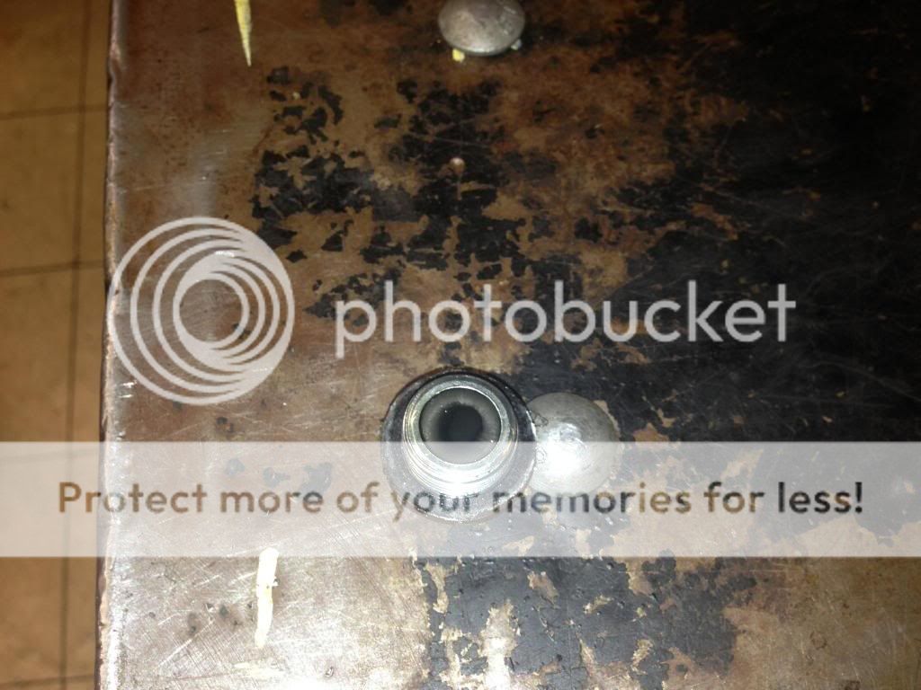

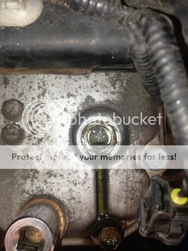

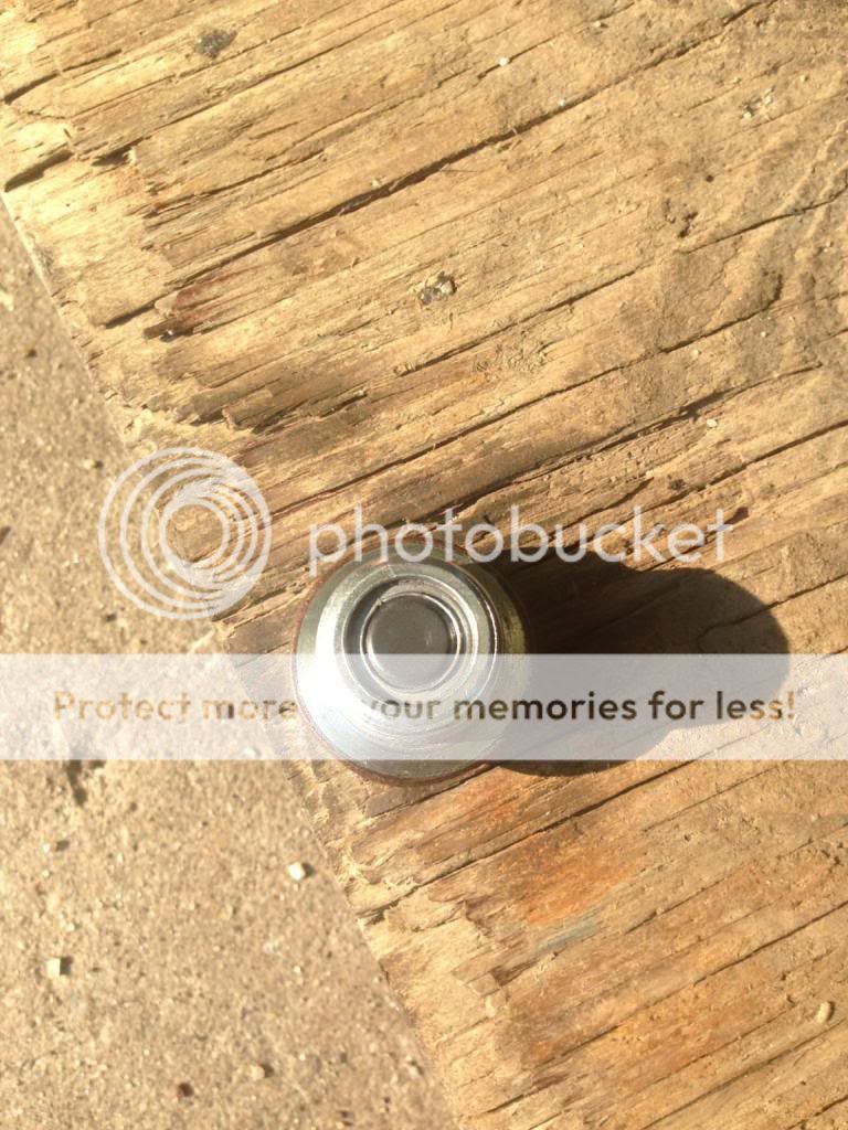

Here's the before and after of the drain plug:

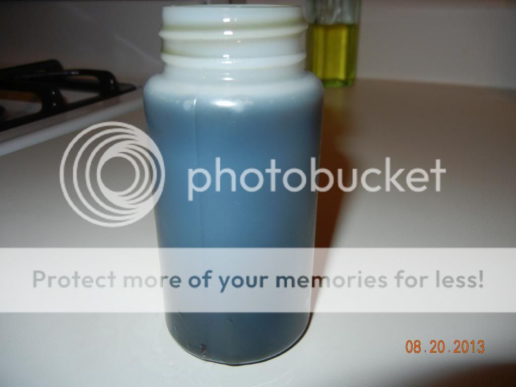

Here's what the oil looks like after ~1,200 miles:

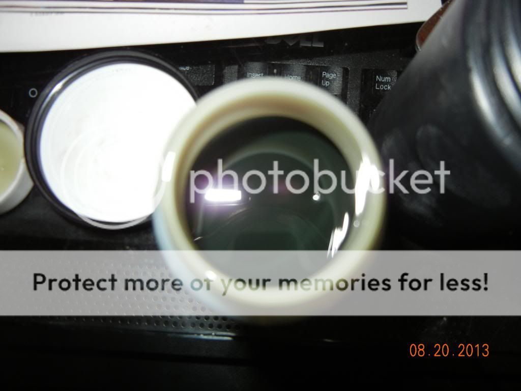

Compare all of that to the factory fill @ 17,000 miles:

I'm going to say that if the differential is binding that's the source of what your seeing there. I don't think that a little overfull on the oil is going to murk up the oil like that or generate all those shavings that your seeing on the magnet. I'm not familar with subaru but the rear diffs I've seen would be very difficult to overfill to the point of being dangerous. I once had a 94 aerostar that merked up oil and generated shavings on the magnet like that and when we took it apart a tooth was chipped and the chip was wedged into a gap between the gears and the axel. We ended up removing the chip and changing out all the bearings. Everything was fine even with the chip missing out of the gear.
