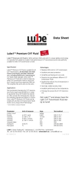

It will be similar to this Fluid it seems.
