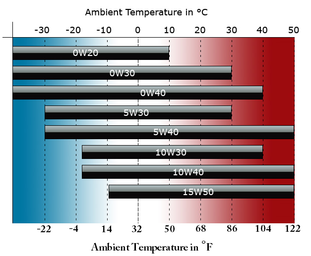

It depends on the temperature. Any oil at low temperatures is thicker than any oil at operating temperature. When will people ever learn what the winter rating means? A 0W anything is massively thick at 0F compared to any oil at 150F.
Furthermore, depending on the temperature a 0W-XX oil can be thicker than the corresponding 5W-XX oil until it reaches very low temperatures. People on here really need to learn what the winter rating means and what temperatures the ratings are determined, and stop posting nonsense responses.
A 0W oil is not automatically thinner than another rated oil and all are massively thick at low temperatures.

He's absolutely correct. It's about temperature.
