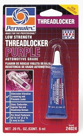

I sometimes use purple thread locker for stuff like that.
http://www.amazon.com/Permatex-24024-Strength-Threadlocker-Purple/dp/B000HBGHFY/
