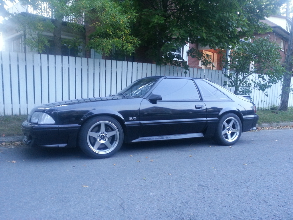

BTW, here's a dyno pull of my buddy's 300RWHP '87 that he recently sold:

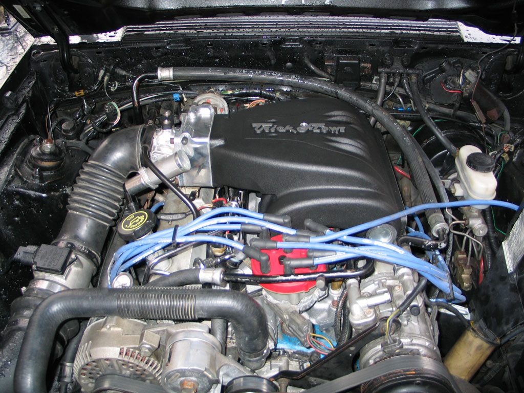

Engine bay shot:
And a nice shot of the car:
