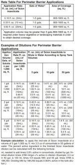

You are 100% correct. More liquid helps with penetration into "difficult" pervious surfaces during a perimeter treatment. The label lists product quantity by square footage for perimeter applications; the oz/ gallon figures are reserved for crack/crevice or spot treatments. Every person may use a different amount of liquid per 1000 sq-ft due to various factors (e.g. walking speed, nozzle tip, pressure setting, etc.), but the quantity of insecticide required for a given square footage should remain the same.
After testing out the XR11004 on setting #1 with my Typhoon 2.5, I am dispensing 3 gallons per 1000 sq-ft. So for me, if using the product above, I should be adding no more than 20mL.
