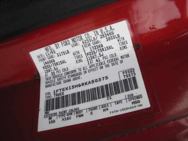

to me this is still kind of confuisng. i always thought the gvwr was lower than the gcwr. my GVWR is 8650. any thoughts on this. lets not argue either lets just keep it cool.
ok so is the towing capacity assuming the truck weighs about 4500 lbs 6450-4500= 1950? and then my payload capacity is 8650 - 4500= 4150. to me that seems backwards but the way i read the letter states that.........
GVWR must always be below, or never more than, GCWR. For GVWR to be bigger than GCWR would make no sense. I don't see where they state GVWR in the letter. If your GCWR is 6,450lb then it is possible that GVWR is likely 6k, give or take. [Pure swag on my part, going off my impresion of what a 1/2ton truck should be for GVWR.]

my GVWR is 8650
Where did you get this number?
Wikipedia has the 93 F150 listed as 6,100 lb GVWR max
Did you send a pic of the GVWR tag to Ford?
edit: doah, photobucket is blocked at work. Bummer. Am curious what this tag looks like.

Does the VIN number on your GVWR sticker match the VIN number on the dash?
Originally Posted By: chevyboy14
my GVWR is 8650.
You have got to be kidding.
Didn't the Ford dealer confirm the sticker is wrong and not original? Why would you go off a sticker you know is wrong?

they guy at the dealerr said he thought it was wrong but i called ford after getting the email from them, they said it is in fact correct...... which is why its confusing

keep in mind my sticker is just like yours only close up. it looks just like that except its not in the crease. my sticker isnt wrinkled either. its just the picture.
see the smart [censored] comments are coming again. i am just trying to understand this and once again we start making bad comments. please lets keep this educational and clear. it has nothing to do with missouri and you all know that.
The only explanation I can think of is your sticker is simply WRONG. Period! The people at Ford who are saying it's correct are probably not taking the time/effort to actually look up the correct specs and are just saying, "just read the darn sticker. If the sticker says it is 8600, then it must be 8600." Without actually confirming it.

Look at your crummy, wrinkled sticker compared to the correct one...
Notice how much is missing from your sticker. Notice how bad it looks.
Why would you believe the hack job sticker on your truck
notice my front gvwr and rear is higher too. its not just the whole gvwr
