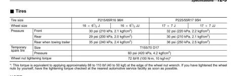

I thought those studs recommended 67ft-lb
I wasnt questioning your reference material. Maybe they changed it? I swear the 2011 forester was 67ft lb.(in 2011) I always thought it was too low and would use 85ft lb.
Found an old manual it says 72ft-lb.. so I'm not totally bonkers... ;)
