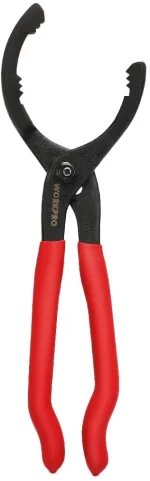

I’m not a mechanic but I have had a few stubborn filters I have had to deal with. My best results were with wide mouth Channelocks. Most of those were the factory filters.
The old screwdriver through the side might have worked on older filters but today’s filters use a thinner metal body and I would surmise the result might be not as successful.
That’s good I need to get me a big pair of those channel locks.
