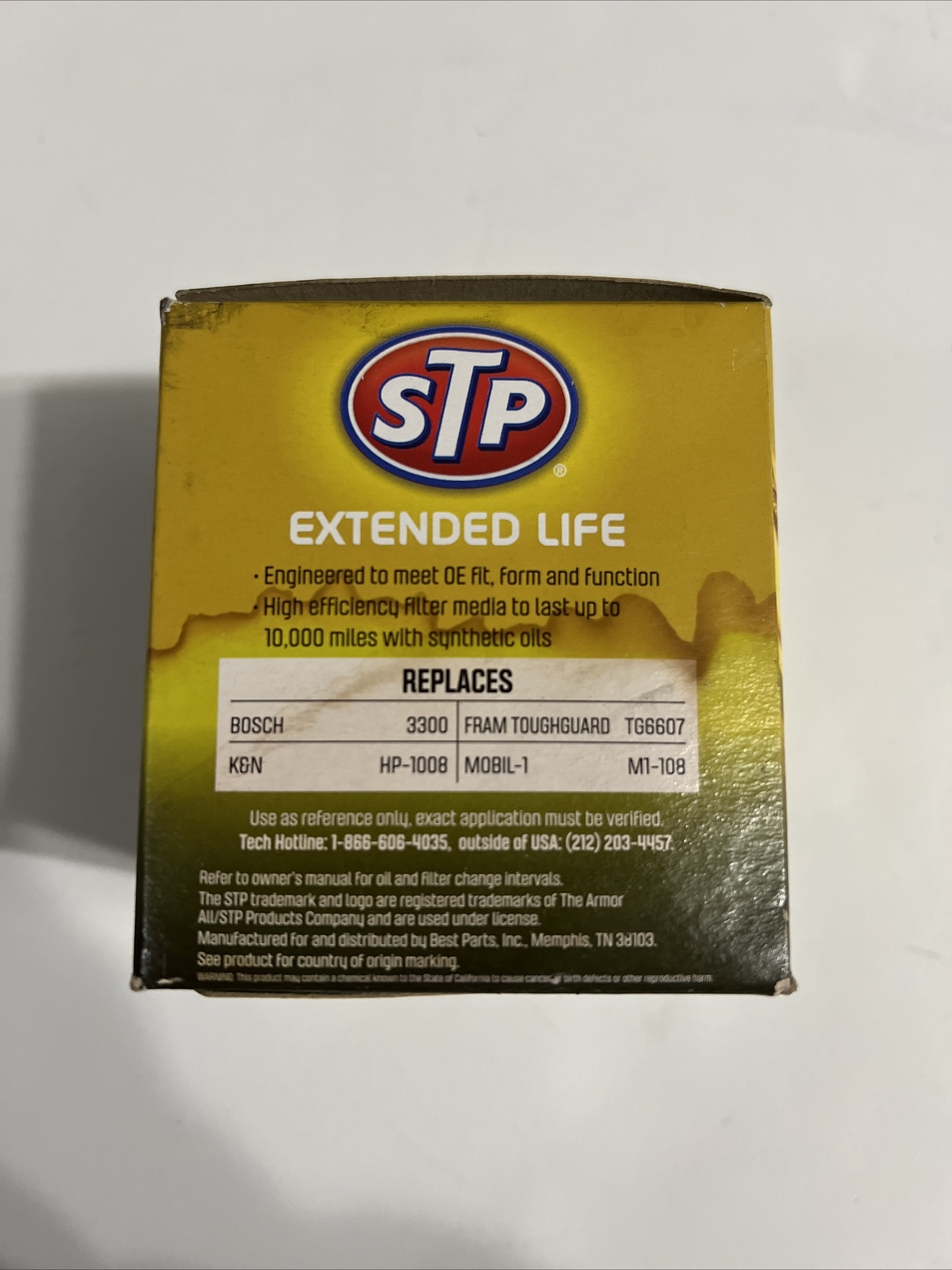

You can always look on the back of the box..
If it has this number for "tech hotline" then it is a Premium Guard: 866-606-4035
