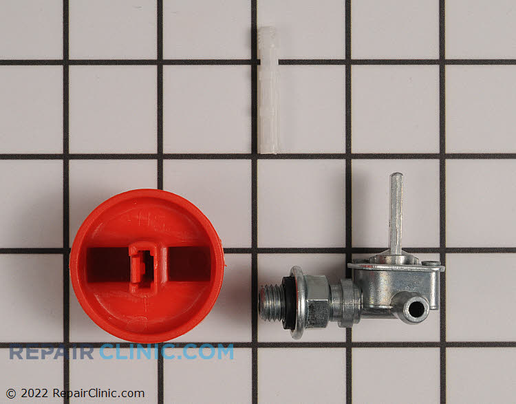

Had this been a newer LCT engine powered Ariens, my bet after ~2yrs of no use would be the fuel shut-off valve would have started hemorrhaging fuel at an alarming rate. Seen a few of these issues now with friends/neighbors. My fuel valve started feeling very crunchy on the LCT on my 3yr/old Ariens Snow-Tek, so I've left it on and are not touching it for now. Friend of mine had his come right apart when he twisted it to the "On" position and dumped the contents of the tank on his driveway.
YEP - - The one in my Champion water pump swelled and shut off fuel supply inside. I had to cut out the section of the rubber piece between the two holes and made a mental note to never touch it ever again.
