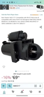

From the picture below, does the starter have a Bendix drive to spin the gear up or an arm part of the starter solenoid pushes the gear up?
How can they make a starter for $70?

No pic attached, but a quick search shows some pre-engaged type starters for that engine...a quality marine specific one is a good upgrade.....and I would not use a "$70 starter" on any boat I would be on, but that is just me.

Ok screenshot attached. Forgot.
I would not use a $70 starter in my Chaparral but how can they even make a starter for $70.
