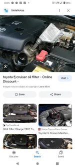

Our fj cruiser does. The filter mounts on top,threads down. I have to use silicone valves or they will drain overnight. Here is a pic I stole from the Internet
