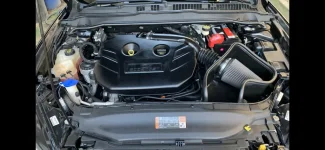

I’ve always cleaned my engine bays. Easier to identify a problem or leak before it becomes serious. Plus, I’ve heard that dust and dirt caked on the engine can cause a lack of heat removal and force the cooling system to work harder. Ford also recommends cleaning the engine in the owner’s manual. Either way, I love a clean car and engine bay. 145k on the 2015 Fusion.
