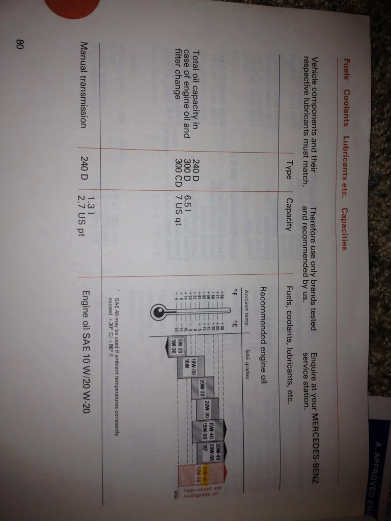

15w oils are ok to between 3-23F per the Daimler and other viscosity charts.
Well aware of what the charts specify. I'm just saying what I've done. I'm talking -5° F at most. Colder, and I'd plug in the block heater, and likely run a 5w40. Never had a problem with the MDT and HDT trucks I owned at those temps with 15w40, either.
