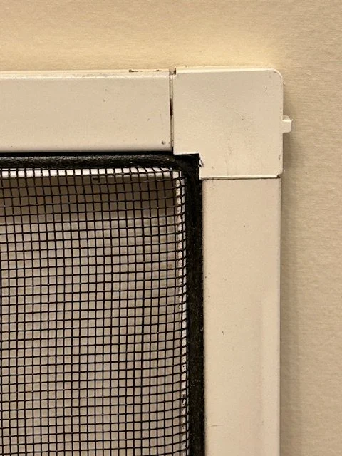

This is the corner on my factory screen - which you can use a single spline. I actually found it better to use 2 splines - each covering two sides. You can then do apposing sides and get the screen nice and straight to start, then finish with the two adjacent sides.
If I had to use 4 spline pieces I don't think I would car much - but each spline must go completely to the corner.

Dad took a photo of the busted screen. Looks like it was made with corners, and they just snapped after years. The repair will be a lot easier although I think springs would be helpful. The mesh isn’t perfect, but there are no tears or holes.
