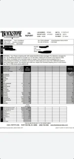

Well, this car is on E85 and methanol and on the track quite a bit. It sheared Amsoil SS 5w30 down in 2k miles. I was looking for something a little more robust.
Are you sure it was mechanical shear or was it fuel dilution? How are you determining shear?
I'm assuming it was mechanical shear due to the UOA.
