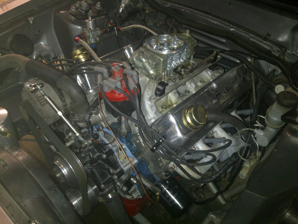

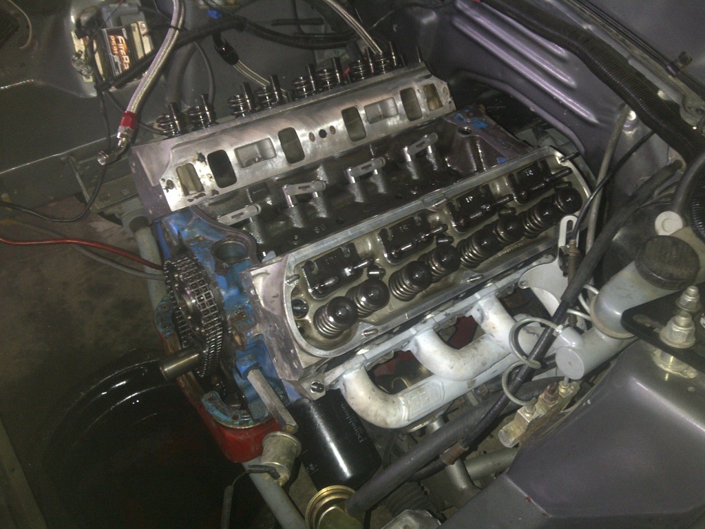

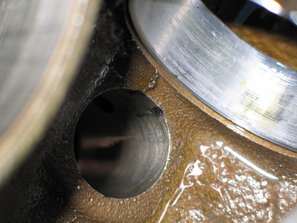

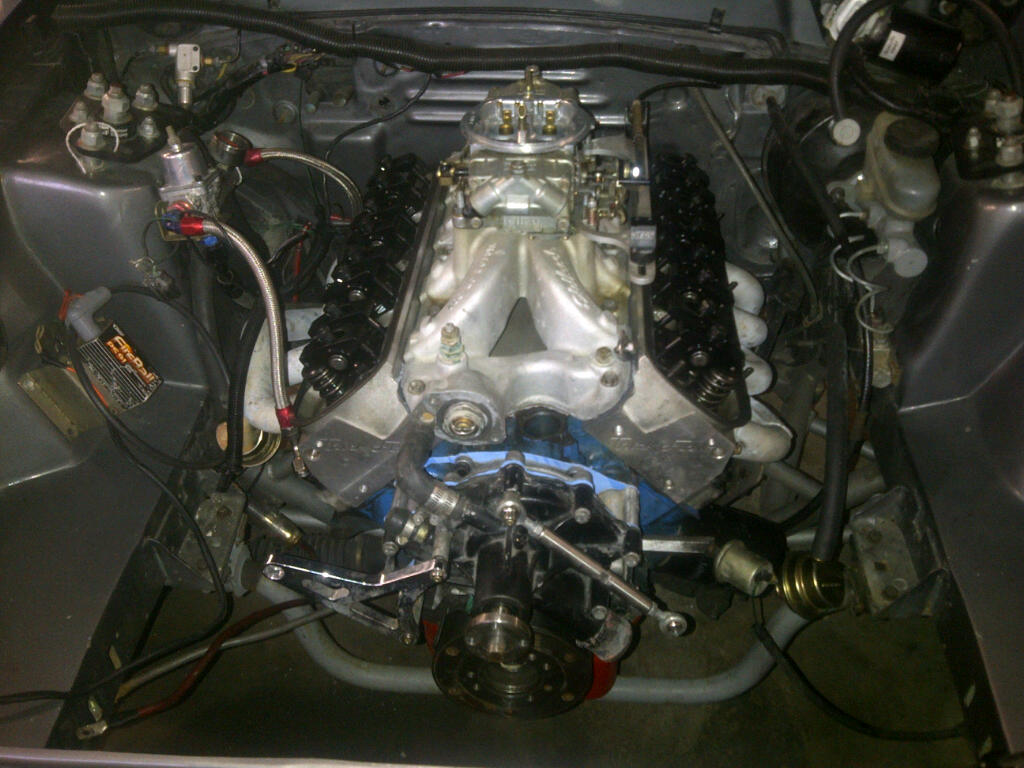

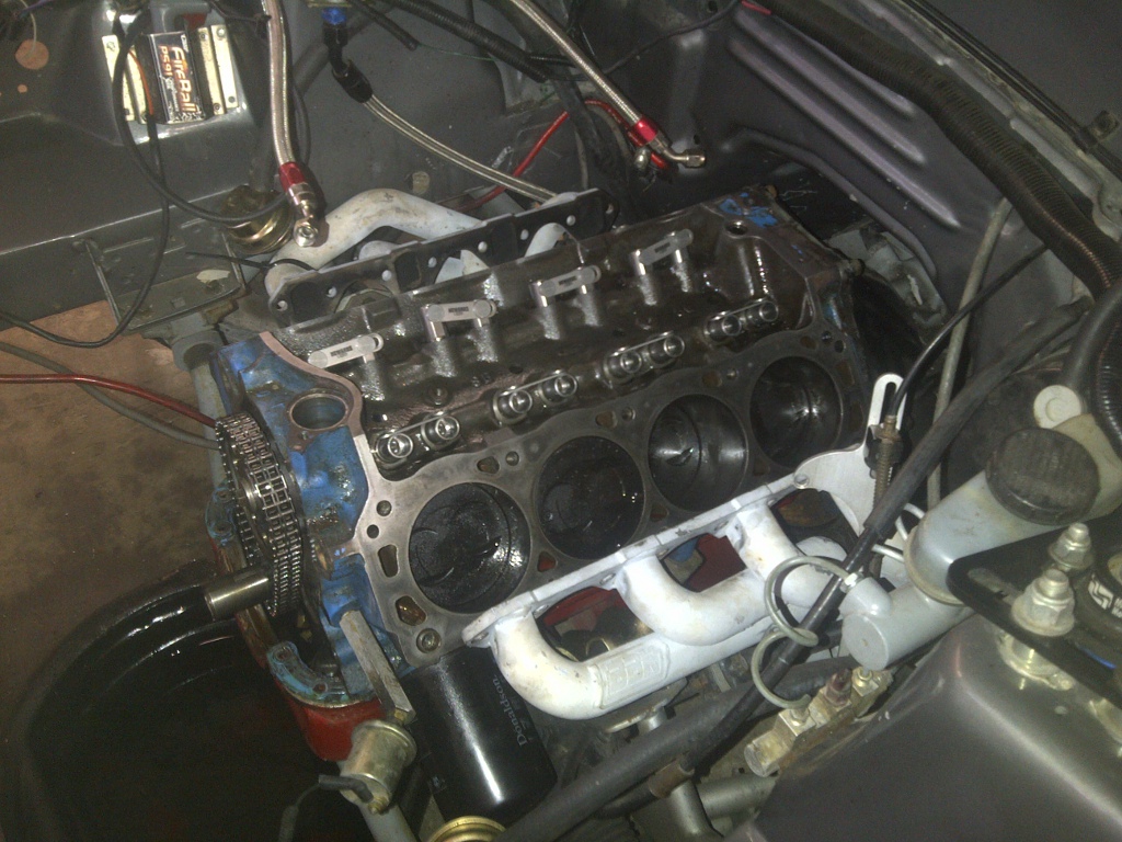

I've built several 302HO's, as I used to be big into the Mustang scene. Stock roller lifters, which mine had well over 300,000Km on them, were good for a MAXIMUM RPM ceiling of 7,000RPM and a maximum lift of ~.550 with a 1.7 ratio rocker due to the limits of the stock dog-bone and hold down setup. If you wanted to go above that, you needed aftermarket link-bar lifters. If you wanted to go well above that, you needed to switch to solid roller.
In order to retain control over the lifters at that RPM (7K) you needed heavy springs. This is due the the mass of a hydraulic roller lifter. I had a custom camshaft ground by Camshaft Innovations, and he (Jay Allen) recommended K-Motion K800 valve springs, which, at spec height, were close to 500lbs open. He was adamant that it was all about lifter control and his cams tended to work extremely well, and I don't recall anybody losing lifters when they followed his advice.
In that vein however, we did "inherit" a 302HO in an '85 GT that had a CI cam in it, but the guy had gone with aftermarket lifters. They failed. There are pictures of it on here actually. We picked up a stock low-mile shortblock, stuffed that cam in it and put in the proper Lunati link-bar lifters and it ran like a scalded ape right to the rev limiter. That engine survived two cars but eventually the Comp springs on the TFS TW's that it was wearing got some wear on them and she started into valve float at much over 6,300RPM, despite the engine wanting to go to 6,800+. My buddy sold the car, but that was a solid 300HP at the tires engine injected, more when it was topped with a Victor Jr. and a Holley HP.
The failure mode of those aftermarket lifters BTW, was nothing like we are seeing here. The pins holding the rollers in actually walked out, impacting the lifter bores. It was wild.

And here is what we did with the cam that came out of that engine, note the linkbar lifters:
