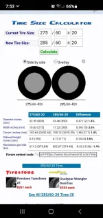

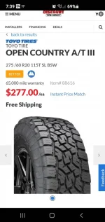

These are good looking tires. If I wanted next size wider would I get the 265 or 285? 275 is the size I have now.

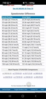

Found this tool online. Looks like a tad taller and wider. I think the 285 might look better. What do yall think?

the first number is the section width in mm
second number is the ratio percentage of sidewall height
so you would want 285 but they would be slightly taller -bigger overall diameter as well.
if 275 is the stock size.. there shouldnt be any issues going to that minimally bigger size.
