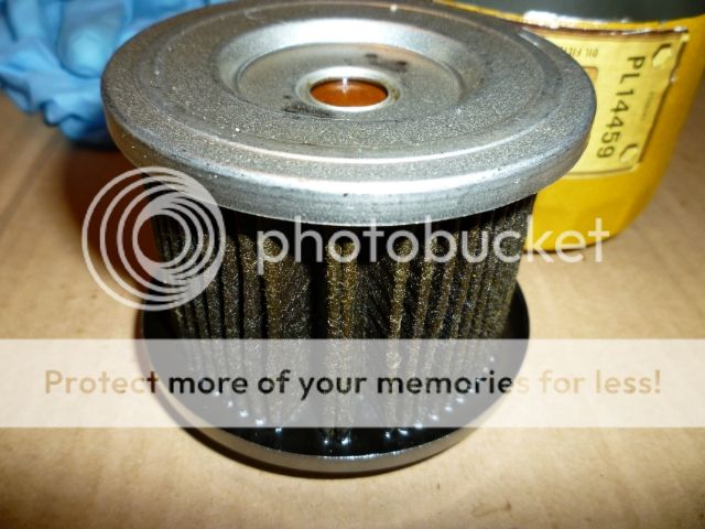

Here's pics of the bypass from a PL14459 showing the coil spring type.
Good pictures. I have a new Bosch WS or "workshop filter" here, their lowest offering. The center tube holes were punched out mainly on the spiral ridges in the center tube. This leaves like a thin bridge of metal over the hole. That's very bad, as bad or worse than a hole in the media. Potentially a piece of metal is headed for the main bearings. The Bosch Premium I also have here has the holes punched out between the ridges like it should be. To my eyes your Classic has the holes punched on the ridges too.
