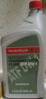

HONDA Fit ( 2nd generation ) : A.T.F. Drain + Fill at 64,794 mis.
Out : H.G. DW-1 ( 32 ,000+ mis. of use )
In : H.G. DW-1 ( 2.7 qts. )
Used a NEW HOLT Fluid Extractor and worked great :D . Click to enlarge. IMG_5290.JPGIMG_5288.JPGIMG_5289.JPG
