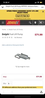

I have a fuel transfer pump coming tomorrow for a 2016 cab and chassis Duramax with the dual fuel tanks (23.5 gallon front, 40 gallon rear). The transfer pump is supposed to pump fuel from the rear tank to the front tank as it is depleted. When you refill the fuel tanks, the front will be empty and the rear will still be full. It keeps throwing a P2636 and defaulting the fuel gauge to empty. It has already had the N162051380 revision done so I think the fuel transfer pump is not coming on when commanded. The transfer pump dying on these isn’t too uncommon, but at least it’s easy to get to.
The transfer pump didn’t fix it like I was hoping. So, I pulled the flatbed off and pulled the fuel sump/sending unit out of each tank. The rear tank float/arm was floating in the tank. Two of the tabs that hold the float arm onto the sending unit were broken off. This truck was T-boned in December and not fixed. I think the side impact sloshed the fuel around pretty hard and broke the arm off. We’ve been having issues with the dual fuel tanks since it was hit, it threw a P2636 while the officer was writing up the accident report. The other driver was 100% at fault in this accident and his insurance paid for the fuel system damage and to replace the flatbed plus all labor. The damage was all to the flatbed. It folded up the front toolbox that was hanging under the flatbed and tweaked the aluminum flatbed just a little. The flatbed hangs over the passenger side just a hair more than it does on the drivers side. I removed the drivers side tool box and it looks fine without it. The accident bent the front mounting brackets for the bed just a little. I’m probably gonna have a friend cut me some new brackets on his plasma table while I have the flatbed off the truck. The ball and hitch mounts are bolted directly to the frame of the truck so there is no concern there as far as damage from the accident goes. I also ordered a new filler neck and cap for the rear tank. The cap was broken off and the filler neck got bent slightly when the truck was backed into something in an unrelated incident. A new cap will not screw into the bent filler neck. GM makes you buy the whole filler neck assembly with the hoses and everything. I also ordered a few other various parts that I need that would ship from the same warehouse since it wouldn’t add anything to the shipping cost. RA has pretty good prices if you can get lucky and get it all to ship from the same place. I used a 5% off coupon.
