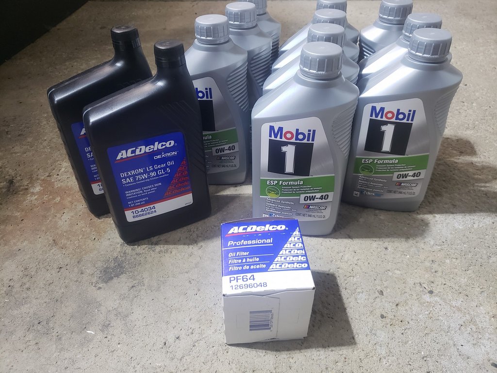

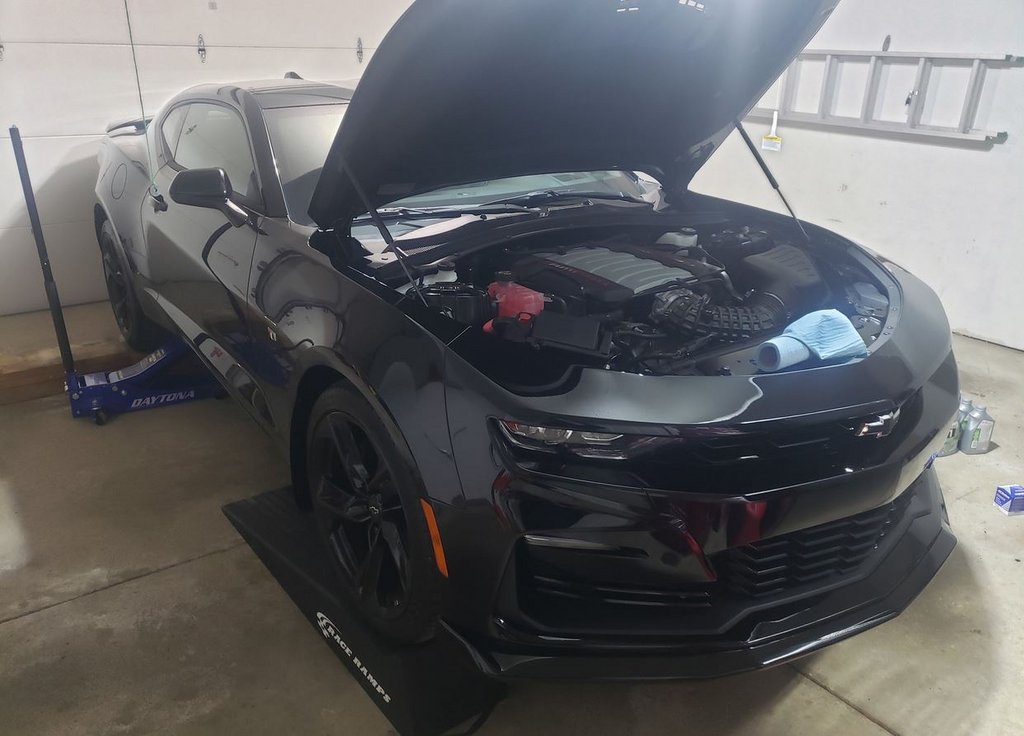

My Camaro SS just hit 1,500 miles, so just did my second of two early oil changes (the first at 500 miles and now this one, so following the OLM from this point on for the most part). Also changed the rear diff fluid as well... The magnetic plugs had quite a bit of break in material on them!
It got 10 quarts of M1 0W40 ESP, PF64 Filter and 1.2 quarts of ACDelco 10-4034 75W90 in the diff.
