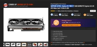

I'm glad to hear you say that about Sapphire. My wife and I decided on this card. We are going to hold out for some holiday deals.
I got this exact GPU during the black friday week. Great card, runs cool and quiet but it is big and thick, takes three slots, so keep that in mind.
