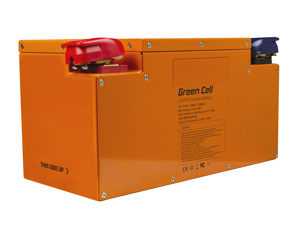

tried anybody this ???:love:
like in car or backup supply ?
