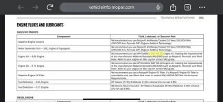

Hello!
Why is that?
0w20 is on the oil fill cap and the only viscosity recommended for this engine in the manual.
Thanks!
IMO and the opinion of people who know a lot more about oil than I do, it's a better choice for that engine. Hot topic, and opinions will vary. I suggest you search the archives, a lot has been written about thick vs. thin, MOFT, HTHS, etc. Also check your air filter and the related air filter plumbing.

Hello!
I’ve been doing a lot of research on this. I believe I even found the individuals you are referring to, including an engineer on the first generation PentaStar. It seems like the Generation 1 PentaStar was designed for the heavier oil, and the change to lighter weight recommendation was driven solely by efficiency requirements. However second generation engine they started phasing in around 2016 was redesigned specifically for 0w20.
Take it with a grain of salt, just what I’m pulling together.
Regardless, it seems like the PentaStar will have a long service life with any decent oil and regular changes when the oil life monitor says to.
