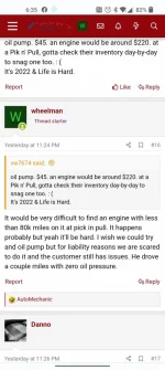

yes I can see the liability there. At least with a wreck you know it was on the road & viable. But you can't ask a paying customer to trust it. lol.It would be very difficult to find an engine with less than 80k miles on it at pick in pull. It happens probably but yeah it'll be hard. I wish we could try and oil pump but for liability reasons we are scared to do it and the customer still has issues. He drove a couple miles with zero oil pressure.

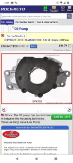

oil pump. $45. an engine would be around $220. at a Pik n' Pull, gotta check their inventory day-by-day to snag one too. : (
It's 2022 & Life is Hard.
I can see that too. it may be time to go up market to LKQ.There are no L83 engines at a Pick n' Pull yard that are in better shape than the engine in the truck. Pick n' Pull yards (At least here)...Are the overflow of old/low demand vehicles & parts from inventory controlled wreaking yards, With the core value of a buildable L83 being pretty high....I doubt one will be going for $220 any time soon.
This doesn't fix the internal engine damage that has likely been caused by running this engine with zero oil pressure. It's all a lot of labor. Of we went this route and engine failed the customer would be pissed rightly so.Rock auto
