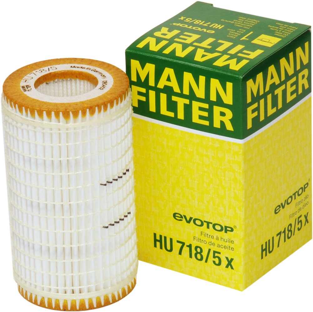

Some cartridge oil filters for some engines have no core at all, just a plain pleats of media keep in place by 2 end caps.
A cartridge oil filter for many Mercedes engines:
Maybe it slips over some kind of center core structure built into the engine ?
So you guys have no concern about the pleats being so tight they practically bind against each other on the center tube? Seems like that starts to cut back the usable surface area at some point. I've always appreciated the fact that P1's pack in a lot of media, but there does seem to be a point of diminishing returns, and it looks to me like maybe this cartridge format has reached it. Of course that MANN cartridge looks about the same, so maybe more oil can flow out of the cracks between pleats than I think.
