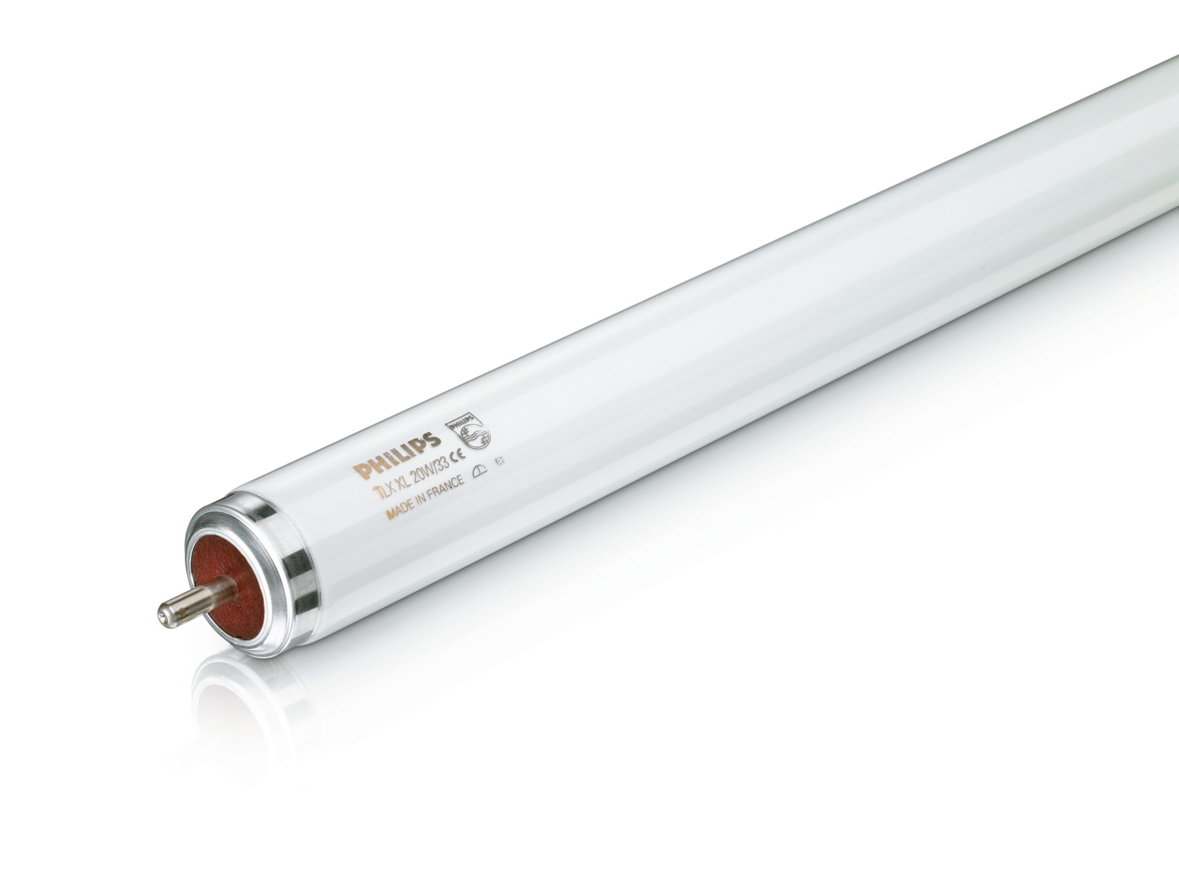

sk_pete Joined May 18, 2021 Messages 1,399 Location central europe Jan 3, 2023 #25 TL-X XL | Philips TL-X XL TL Fluorescent lamps and starters | Philips www.lighting.philips.co.uk
