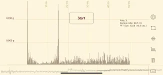

Look up my posts on using a phone for vibration analysis. Drive on an otherwise smooth road at 60MPH and take data. If it’s what you say the vibration should be 1Hz or 0.5Hz.
Post data.

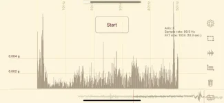

-vibration analysis below. I did it at 60min but it doesn’t vibrate at that speed. The below is when it begins the cyclical 1second vibration at 80mph.
-dropping the car in neutral does not change the vibration, so I can assume its nothing engine related.
Any thoughts on it?
First image 80mph, second is 60mph
