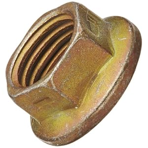

When you see the square indentations on the sides of the nut like
this one, that's an indication of it being a locking type nut.
