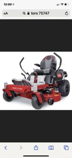

I recently purchased a new Toro Timecutter 42”. The machine runs great and seems to be well built but the cut is less than desirable. I have checked the side to side and front to rear level of the deck. I have checked tire pressures and even adjusted the anti scalp wheels. I just can seem to keep this machine from stair stepping my yard. I know to some it may not appear to be too bad, but this is a new machine. On a sodded yard it should be cutting golf course quality in my mind.
Can anyone throw out some suggestions for me to try. I am out of ideas to try and get this mower cutting level.

Is the deck binding on anything ? drop the deck to cutting height and check the movement of the deck. maybe try cutting one step higher ?
Golf course cut quality? Is this mower from a big box store? Please give us a model number.
It’s a Toro 75747. It did not come from a box store, a local mom and pop Toro dealer.
