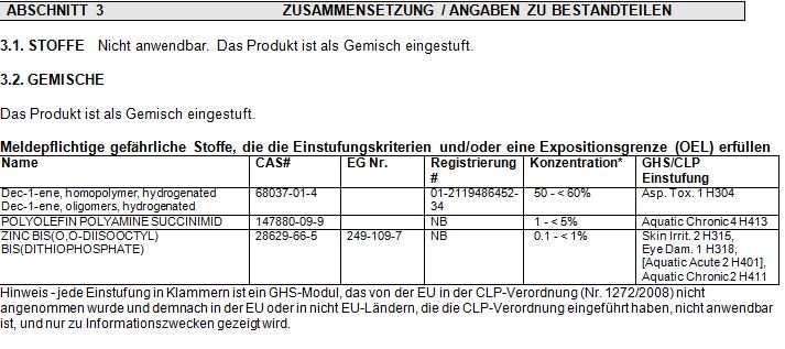

This is the current (or was when I snapped it a few months ago) MSDS:
Shows 50-60% PAO.
Have no idea. I know it has exactly same characteristics as old version here, plus unlike here in Germany it is sold as SHC oil.
On other hand here we have pds for 0W40 ESP but you cannot buy it anywhere, so maybe M1 started to behave like Castrol with these MSDS's and pds's.

Well I'm assuming the other 40-50% is probably Group III/VISOM so perhaps they've just continued to label it SHC so that if they add more VISOM they don't need to change the label
The previous MSDS showed more Group III IIRC, and I don't recall a product labelling change when the MSDS changed, unlike in the US with the FS designation showing up on the new bottles.
So Mobil 1 0w40 has 50-60% PAO and yet can't meet the BMW N20 spec. Maybe just because an oil is predominantly PAO based doesn't mean it'll be better than a predominantly Group III oil. It's the whole formulation with a stout add pack, friction modifiers, dispersants and detergents that make a well rounded motor oil.
