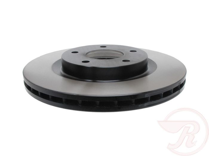

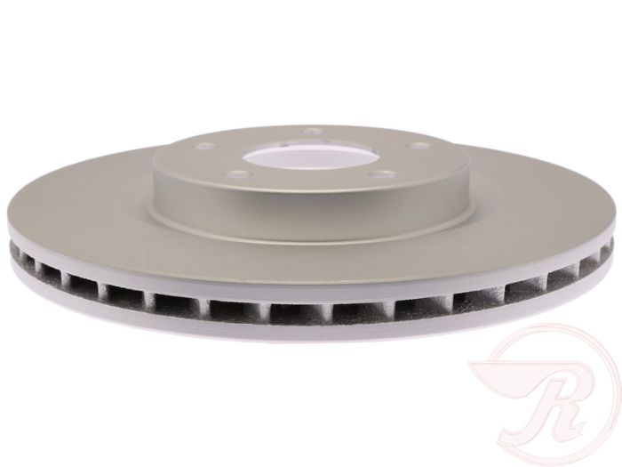

It's all a great mystery. For my application (Patriot), the Element 3 shows the gray fusion coating and the specialty version looks like the old Advanced Technology rotor with black painted hat/vanes.
780459FZN
[Linked Image]
VS
780459.
[Linked Image]
NAPA # = UP 880459CR or UP 880459 ...what's the CR difference?
