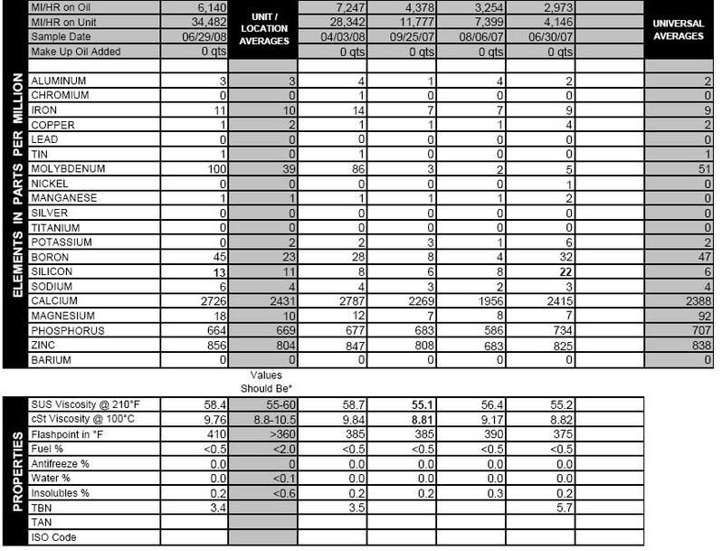

Hey guys...Blackstone sent me a revised report regarding the flashpoint , cst, sus, etc....they originally had the specs down for 10W30 rather than 0W30...the revised charts shows the numbers did quite a bit better than shown before no?

As far as prior UOA's listed...the 2973 was with Valvoline A/C 5W30, the 3254 was with Castrol GTX 5W30, the 4378 was with Kendall GT1 Synth Blend 5W30 and the 7247 was with Pennz Plat 5W30.
Other flavors this engine has seen is Synpower and blend of 4qts of Havoline Synth with a quart of dino Havoline old formula mixed in.
Right now there is Shell 5W30 in there....I have a bunch of it I bought real cheap at Walmart that I need to use up. Also have a bunch of old Havoline dino that may make it into the sump at some point...it is the SL variety so a little leery of that...any reason not to?

Actually the viscosity is back within grade with the corrected report.

The values at what is should be at changed because Blackstone originally processed it's findings as a 10W30 rather than 0W30...as a 10W30 it was out of grade...as you can see on the 2nd report the numbers look a lot better in that regard (I think) lol
