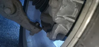

I didn't see the cutout because the stadium lighting they were using was facing towards me. Said cutout was 2' long and the width of the lane, unavoidable. After I hit it, some seconds later my wheel swung out and crushed into the fender. The lower ball joint had sheared off. The balljoint did not pop out, it broke in half. Fortunately this happened to my Honda and not anything overly valuable.

Though that ball joint probably had wear before it popped. A good one should have taken the hit.

You'd think. It snapped it clean off, which is pretty hard to do. The lower ball joint on the Accord is stout imo.

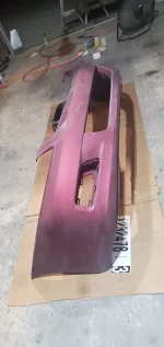

Ah someone brought this back up after 1 year, believe it not I'm still fighting with their insurance company about this claim. Though they did pay for the bodywork estimate just recently, $2900. But the separate estimate for the suspension damage/broken axle ($1450), they have not, yet.

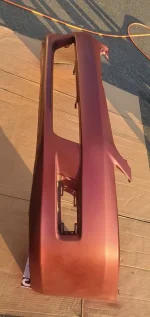

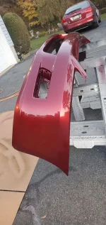

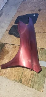

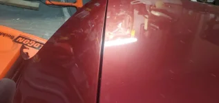

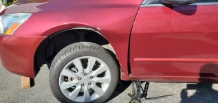

I just finished up putting a new fender on and respraying the front and some other parts. Came out looking fantastic. I was patient and found a same color fender, but with the variants on this color, that doesn't mean it would match. The clear coat was not in great shape on the new fender so I sanded it down carefully, 600/800/1000, mixed some fresh Redondo Red base coat into the clear, and put two coats on it. I don't have a photo but the match to the door and hood is excellent. The bumper had failing clear and 9" crack from this accident, I repaired it and filled the front plate holes. So it was resprayed with basecoat but I blended it into the sides of the bumper in case it wasn't going to match well against the fenders. Really came out great.

since i can't say the swear words I want to.. i'll use the pg-rated version..
DAAANNNGGGGGGG! that looks awesome! great work! I need you to come spray my stuff, that looks better than factory! (y):D
now to force the insurance company to pay for the mechanical damage.. If they won't budge you might have to sue them, they've already admitted they're liable to pay since they paid for the bodywork.. I'm not talking lawyer level, just small claims court.. also..you can also lodge a complaint with your state's insurance board about this and that might get a fire under the insurance company to pay. I know Michigan has one. Not trying to bring the moment down just saying..
But the bodywork is awesome.. yup I said it again!!
