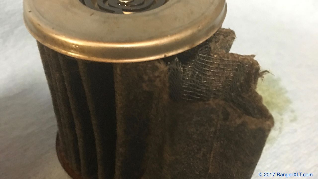

Think all Purolator is saying is the backing mess is also synthetic (not metal). They call it “SmartFusion" where the synthetic media is fused to the mesh backing material.
Yes, take a look at the video I linked earlier and they say that.
Cut Open Puro PBL14610 - Virgin (GREY, Slotted)
as opposed to a wire backed PSL
Cut Open Purolator Synthetic PSL14610 - 5,729 mi
