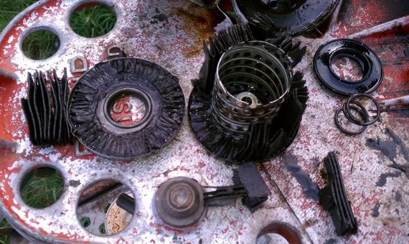

So I recently bought a 1997 F-150, and I figured I should change the oil, since I knew nothing of the history of the truck, and I think it sat a while. I'm glad I did. You may want to get small children out of the room before you look at the pictures.
I crushed the filter slightly taking it off as it was very tight, but there's no way I damaged it this much. As you can see, the filter element was completely broken loose from one of the end caps, and partially detached from the other end. Hopefully the spring kept everything in place.
There's some evidence that the element had started to disintegrate, and I'm hoping that no large bits of this stuff got into the engine. The good news is that the engine runs quiet and smooth.

was the outer can as faded as the picture indicates? if so no wonder it fell apart on the inside. It is utterly amazing to me how some vehicles can just take flat out abuse and continue to run forever. Of course that thing is a FORD.
I doubt much if anything got into the engine, you may want to drop the oil pan and check it just to be sure. I would also get a new trans filter on it ASAP.
I know you dented it upon removal, but that filter looks like it has been on there for ages judging by the can condition.
That's what happens to a filter that's left in place for a couple of years. I'd change the oil a couple of extra times in the near future. It would be interesting to see what a rare earth magnet stuck on to the side of the next filter would pick up. I'll bet your're glad you caught this as soon as you did.

that thing could have been on their for 5 plus years. and most likely was in bypass for the last 3! amazing the lack of care from the previous owner!
i fear for the health of that engine after seeing a filter like that... ick... imagine how old that oil is!
The 5.4/4.6 engine can fail if crud is washed up to the chambers where the oil flows to the cams. This can happen if the bypass valve is on the dome end. Use only a motorcraft filter on these engines.
