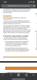

No point, I am just posting relevant info that I’ve ran across since I started this thread. East Penn says in the linked PDF not to exceed 15.4 volts when charging their HD AGM (group 31) batteries.
That applies to Heavy Duty Trucks. Perhaps those AGM batteries are capable of handling 15.4 bolts. I was talking about AGM in a car, because that's what I have.
