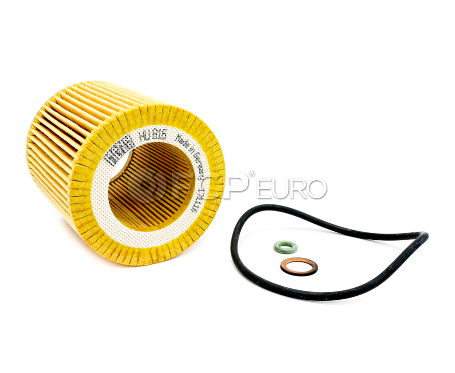

Yep, “Germay” seems having two fonts in it.I don't think M&H mark the filters with "x" .
For example,
HU 951 X filter kit would have "HU 951" printed on the filter...here is 816/2 X :
https://cdn1.pelicanparts.com/catalog/images/SuperStock/11-42-7-512-446-M63_2.jpg
Also,the "y" in Germany does not look right.
https://www.fcpeuro.com/public/asse...ge/open-uri20190104-12707-1lm5gsp.?1546633870

Yeah, looks different.
