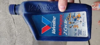

is this 2 cycle oil any good compared to the new stuff?
Jul 14, 2020
1,296
found this bottle while cleaning. don't remember buying it . So how does this compare to the new stuff out on the market? want to use it in my chainsaw, blower and string trimmer
TC-W3 is still a current standard. I also found an oldie. This is Tech 2000, Walmart store brand in Canada prior to Super Tech showing up. This bottle is probably about 20 years old and unopened. It’s also TC-W3 for both injection and mixing.
Right fine in an outboard and some other engines, but for example the stihl ms250 chainsaw prohibits the use of tc-w3 or mixed use 2 cycle oil.
ISO-L-EGD or JASO FD is best for modern OPE 2-stroke engines. I've seen a few owners manuals (for air cooled OPE) specifically state DO NOT use a TC-W3 oil.
For Stihl 4-mix engines, it's probably best to use what's recommended by Stihl due to the unique design of their engines.
lol cost too much to send a quart of oil these days. i will just keep it around for emergency.
i think i will just pony up for some new stuff. just hate wasting stuff
