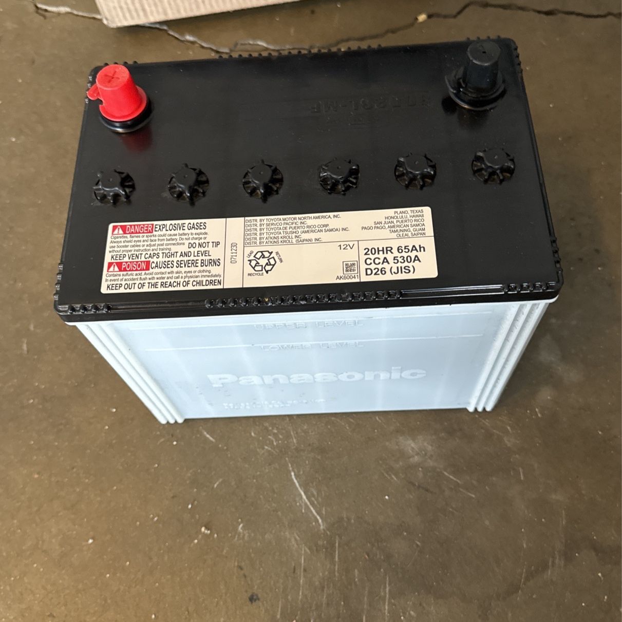

I’d love to get my hands on a Panasonic. My 09 came with one and it lasted 7;yrs without a single care given or a charge to be applied. If I knew the, what I know now about charging, I’d probably still be using it.
