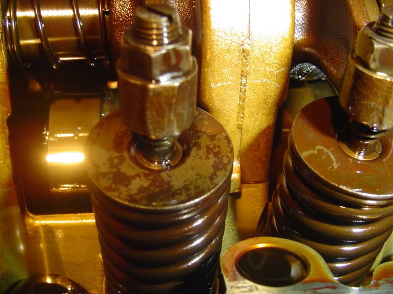

i adjusted the valves yesterday
Took some pix of engine./
Today i did seafoam by vacume hose and some in the engine and gas tank.
After that i switched it to this 7 oil mix that i had planned for a while. Will let it rinse out w.e is in there still. There were carbon deposits in the oil from doing the seafoam.
After that 10-30 castrol gtx with a supertech oil filter.
Engine runs fine on this 7 mix , so far so good. I adjusted the valves and the tapping is Gone but now i can hear the knock clearer. I dont know what it is but I doubt it is rod knock like i thought it was before.
When i start the car it idles at about 1900 rpms and for about 15-30 seconds there is no knock. After that it starts to kncok, loud tap.
The exhaust valves are all noise and contribute to this noise but i doubt this is that knock i keep hearing since i bought the car 7 months ago.

I noticed this was loose but maybe it is soppose to be.

I didn't know hondas had manually adjusted valves. I thought only motorcycles had those and cars were all hydraulically adjusted. Yet I see the adjuster nut and screw. Do you need regular valve adjustments?

Yeah, it's basically a shoe-style follower for the rocker directly on the camshaft lobe; no roller. Pretty primitive design, but surprisingly reliable.

I adjusted the valves about 5k miles ago but it was my first time doing it and they were loud again.
So this time it took me about 3-4 hours, i double cheked, its still impossible to get each valve spaced equally as the others but whatever.
I wish i could open the valve cover again to see if seafoam helped remove some of the varnish.
Huh? You are using a feeler gauge and adjusting the valve clearance to the intake and exhaust specs, right? It should be more than possible to get them all the same. It should be procedure.
