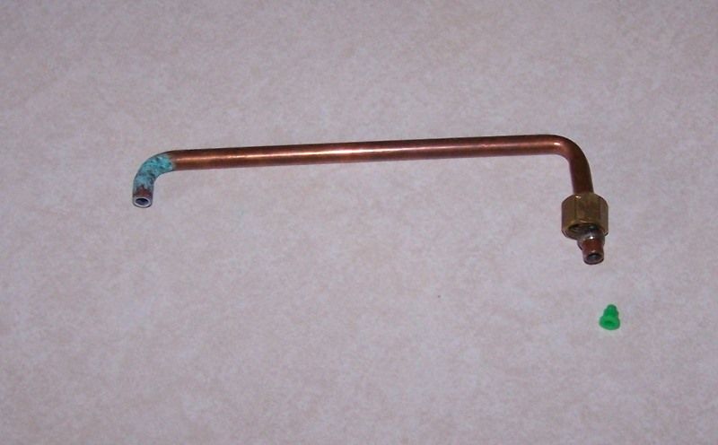

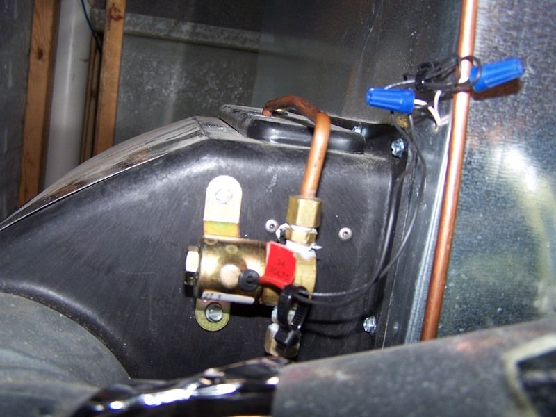

The inlet solenoid does not seem to be closing down completely. There is a lock-nut screw on the outside of it. Any idea what is it used for? the valve opens and closes just does not close down completely. Is it serviceable? At first the metering orifice in the jet was clogged and no water was getting in to the humidifier panel. When I took off the output feed tube from the valve and put it back, the water started flowing but keeps on dripping all the time. Humidistat is working fine and I can hear the solenoid valve clicking and the flow does increase when it opens up.
