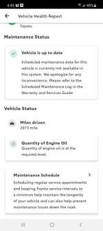

Here's a screenshot of the vehicle health report that is accessable from the Toyota app on my phone. It shows oil level.

I think the sensor will notify the dealership if the low oil light goes on and they could call you to let you know.
The cell phone app has an oil level status with a green ✅ mark saying "quantity of engine oil is at the required level".
to me this is a binary statement, which basically means its somewhere between F and L. If they're adding this as a backup sensor for the app not bad. But if theyre doing what BMW is doing with no dipstick, shame on them.
