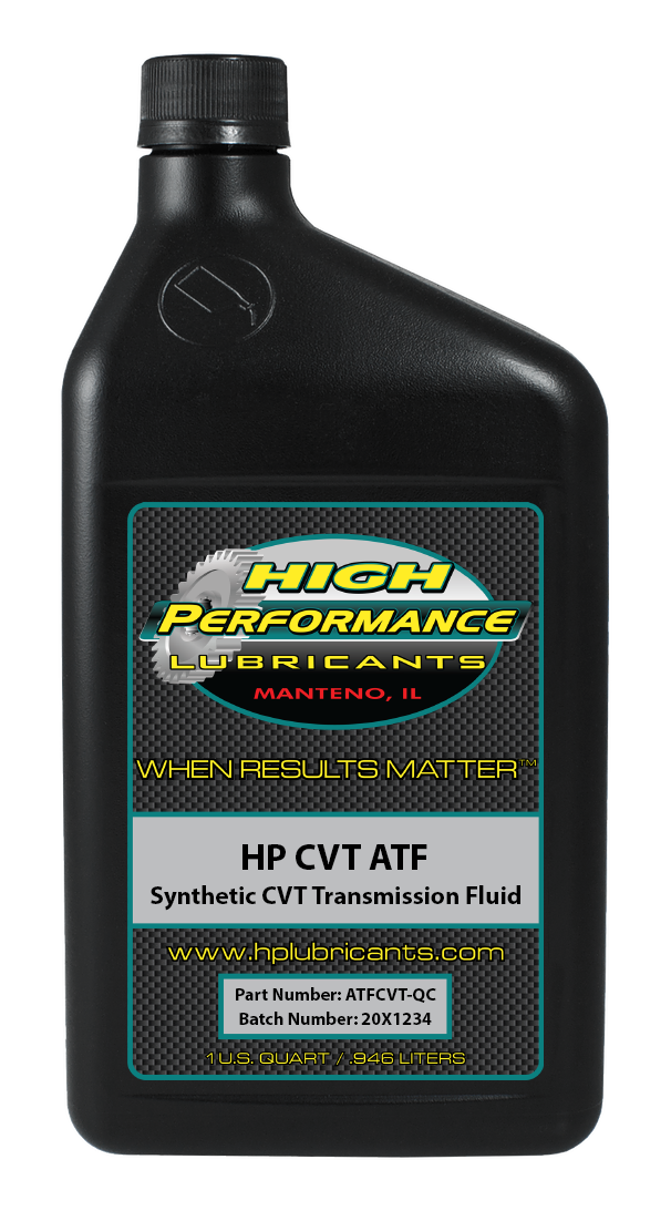

So im assuming its safe to say that Amsoil, HPL, Valvoline, Castrol etc.. has their own CVT fluid that is “Recommended for the following applications” it’s ok to use even though it isn’t oem
The only thing you will see listed from a blender's Technical Data Sheet (TDS) is the fluid's properties and its Recommended for the Following Applications list.
Okay - I used the wrong word. After some further reading and consideration I purchased four quarts of Idemitsu CVTF Type H2 via my nearest NAPA store. This will be a project for another day; need to complete the snow swap and oil change on the Prius V first.
